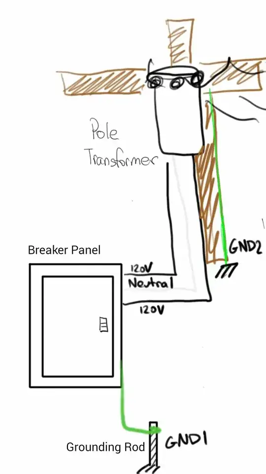

The ground wire is physically connected to a rod that penetrates the soil usually near the breaker box-- this is your local potential. The neutral wire goes all the way back to the source, which is usually a pole top transformer or a generator. The wire can run many miles from that grounding rod -- and can have a potential difference.
Having a separate ground and neutral has lots of safety benefits. Current should travel through that neutral and ground current should be zero. If you drop a hair dryer into a water filled sink some current gets carried to ground. Ground fault interrupters can detect this lost current and trip the circuit.
If lighting strikes all neutrals in the house get raised with the local ground potential and you and your electronics are protected. If you did not ground to that rod, the electrical appliance in your hand would still be at the remote potential of the source (possibly miles away) while you personally are raised to the lighting potential. That potential difference can shock and kill you.
