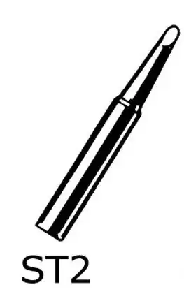

I have an ordinary Weller soldering iron with a conical tip, which I fear does not transfer much heat to the area. Since I am planning to do a dead bug project I thought it would be better to get a flat on the tip of the iron, possibly by grinding it so it looks like this:
However, I am told that this will not work because the tip is not actually solid, but is plated, and if I grind it, then the plating will get ground off. Is this true?
Can I just buy an alternative tip and then install it somehow on the iron, or do I need a special kind of iron that supports interchangeable tips. The type of station I have is an older analog station which is one piece with the holder and sponge on top and a strip of LED lights that indicate the temperature.
