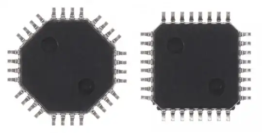

I think it would make sense from a PCB designer point of view, however production wise it is not the best idea.
Comparing a square and octagonal TQFP package with the same area, shows that the ammount of pins stays equal without any problems. And surely, routing a PCB could be a lot easier with this!
