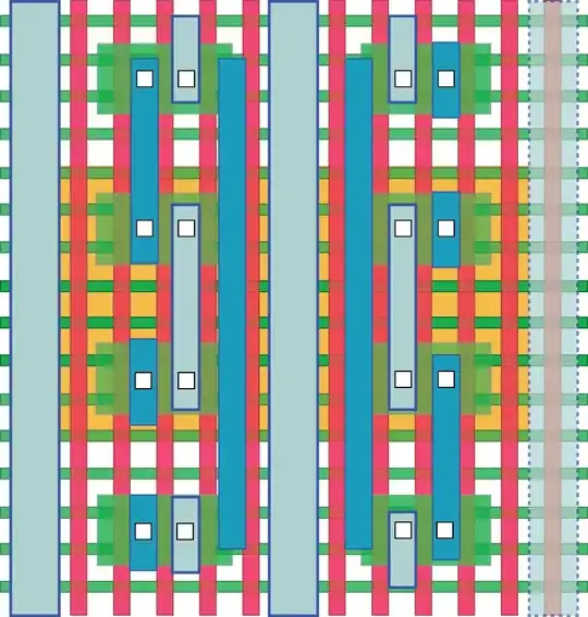

If I were doing a silicon implementation, I would use an XOR because of the symmetric properties. Symmetric circuits use much less power because the stack size is the same that does a few useful things:
  1. Greater effective serial resistance when "off" due to the "stack of 2",
  2. Better matched channels because DIBL is the same on pull up and pull down networks,
  3. More uniform switching time because charge sharing is similar (very dependent on #2),
  4. Usually, better devices as far as lithography so better threshold matching.
A very complete discussions exist for "mirror adders" if you look out there, but they probably only mention #1 and #2.
If you have it in a package, none of this matters.
One thing that will not be in the discussions will be that at smaller feature sizes, we try to do everything as symmetric as possible because of metal rules and coloring. Below is an export image of an XOR from a commercially available FinFET process at 14nm that illustrates the metal coloring. The blue/lighblue are different lithography steps.
XOR layout image

  • Using XOR requires 2 times more transistors than using (N)OR ... – Paebbels Jan 17 '16 at 22:22
    It does, but that does not mean you can clock it faster or have better static performance. The dynamic power will be lower with the NOR in theory, but in practice you will find that the ripple skew causes the transitions to not be as sharp. 0th order, you are correct, but I wouldn't build a system that way if I wanted good power/variance performance. – b degnan Jan 18 '16 at 01:13

    Can you explain what does metal coloring mean? Yes, there are two steps due to process limitations ahem requirements I assume, but is that all there's to it? And if so, why on Earth would someone call it coloring rather than interleaving (since that's visually what it is)? :) – Kuba hasn't forgotten Monica Jun 29 '20 at 16:42
  • @ReinstateMonica Due to the lithographic limitations, you can have two metals on the same layer, but you need to go to a higher metal layer to connect them. I have no idea why the term "color" is used, but it's probably due to the fact that VLSI tools use color to determine GDS layers. I've been updating this recently: https://crypto.stackexchange.com/questions/81191/why-do-5g-4g-etc-use-non-conventional-algorithms/81193#81193 There's links that are pertinent to layout. – b degnan Jun 29 '20 at 16:57
