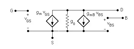

Secondly, in linear operation, when the source is connected to bulk, you don't have to deal with the "transconductance" due to Vbs (gmb) since Vbs = 0. MOSFET small signal model
Image source: http://people.seas.harvard.edu/~jones/es154/lectures/lecture_4/mosfet/mos_models/mos_body_pic_2.jpg

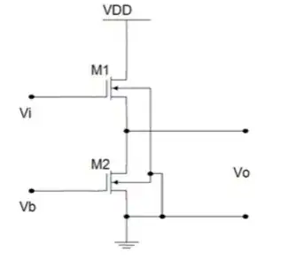

The draw back to this structure is that the NMOS have their performance limited. Simply look at a simple source follower implemented in PMOS and in NMOS (picture of NMOS below). In a PMOS implementation, the NWell is reverse biased in the Substrate (which is p-type) and can float. A PMOS source follower can have a gain of 1.0 if wired properly.
Looking at a NMOS source follower: enter image description here
Picture snipped from (1)
The bottom Vb is simply a current source for amplifier biasing, active load. You can see that M1 has it's bulk tied to ground. That means that M1's source is floating and thus M1 suffers from the backgate effect. The net result is that this amplifier can at most achieve a gain of ~0.8X. In this drawing if you were to snip the M1 Bulk and connect it to Vo the gain would jump to ~ 1.0X.
You'll note that others mentioned that Bulk and Source where connected together to optimize the transistor. In reality that only applies to those devices on the rail. You can see that any stacked transistor will have this back-gate effect manifest itself in any transistors away from the rail.
