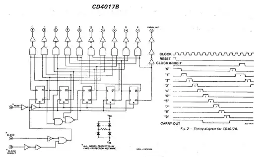

You can get the exact result that you want
by using a CD4017, 1 of 10 counter-decoder,
or the much faster but functionally identical 74HC4017 or 74HCT4017.
(83 MHz 74HC4017 in stock at Digikey for 62 cents in 1's. )
CD4017 datasheet
74HC4017 / 74HCT4017 datasheet
The 4017 is designed to cycle through 10 states maximum, with 1 on (high) at a time, but can be made to produce any lower number by resetting to state 0 when the counter runs past the desired point.
If you are prepared to tolerate a small reduction in pulse width on output zero (leading edge rise time is delayed) you can implement the complete circuit with a 9 x clock input, a 4017 and one inverter. If you want equal pulses on all output a few extra gates will produce the desired result.
The block diagram shows what is involved in "rolling your own" should you so desire.
