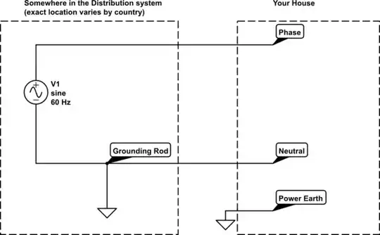

The power is generated across three phases, but that doesn't matter all that much, then at some point the neutral is connected to earth, like this:
schematic
Now, the Earth is safe, we are all connected to it, so, nothing weird happens when we touch it. But if a device is grounded to it, and internally a phase wire comes loose and connects to a metal case, such as in a washing machine, then the current has a safe path back to neutral through the earth.

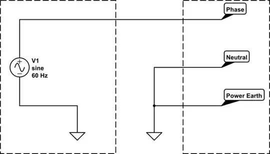

The one exception to my drawing is a single-wire system, where the Neutral is skipped in sub-station to house distribution, but that is excessively rare these days, but that would look like:
schematic
simulate this circuit
But here your house itself still has a phase, a neutral and a power earth. In some countries the neutral wire is there, but they connect to earth at the house as well, but still there will be a phase, a neutral and a ground inside the house. And a well functioning device will never conduct to ground (with the exception of earthed appliances in wet locations, such as washing machine in the bathroom - they are usually allowed to leak to ground).

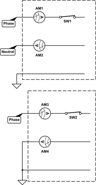

The leakage detection is connected like this, to clarify:
schematic
The current in AM1 and AM2 is compared, if there is a difference larger than a set value the switch opens. So in whatever the situation, if there is current going to earth, through the wire or through you, the switch will open.

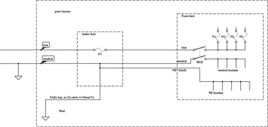

This is calssic EU house wiring, live and neutral.
schematic
