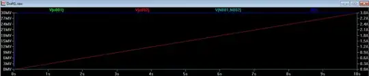

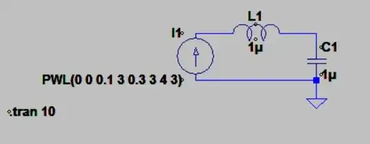

An inductor is a device which adjusts its voltage to keep the same current flowing through. However, the current exponentially decays when there is no source any more. Similarly, a capacitor is a device which keeps the voltage across itself constant. However when charged, the voltage exponentially decays when a load is connected. THe building block of a buck convertor seems to be the L and C. However I am having a hard time understading how an LC circuit actually operates(in a buck). I understand that the capacitor is kind of a snubber capacitor to allow current to flow through and provide a path when the high side PMOS is turned on. However, that job could as well have been done by an resistor, given that Voltage mode control is being used. The only advantage I see to using a capacitor is the efficiency, since energy is not wasted. I applied a current step to my inductor in LTSPICE and this is what I got:
I understand that initially, the voltage at the left hand side of the inductor should actually try to become 0 to allow no current to pass(the initial state). However this doesnt seem to be the case. Can someone explain intuitvely what exactly is going on in the LC circuit. How should it be analyzed?

  • This is not a physical circuit. You can't "step" a current through an ideal inductor. – Eugene Sh. Jan 11 '16 at 16:41
  • What happens in an ideal circuit. How do I simulate one? – red car Jan 11 '16 at 16:47
    In ideal circuit it can't be. You have two contradicting constraints: A forced current change by the current source, and the inductor resisting current change. – Eugene Sh. Jan 11 '16 at 16:49
  • Like Eugene says, your circuit expresses a logical contradiction. See this old question and this one also for similarly impossible circuits. – The Photon Jan 11 '16 at 17:15
  • Contradictory circuits normally mean your circuit model is incomplete. In this case you can make your model more realistic by including output conductance in the source model, or coil capacitance in the inductor model. – The Photon Jan 11 '16 at 17:17

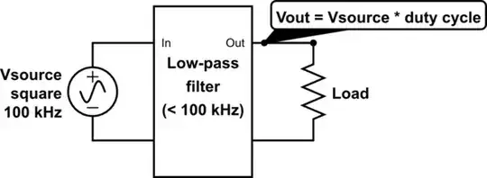

A buck converter is basically a pulse width modulated (PWM) voltage in series with a low-pass filter. The filter's output is (ideally) the DC average value of the PWM voltage:
schematic

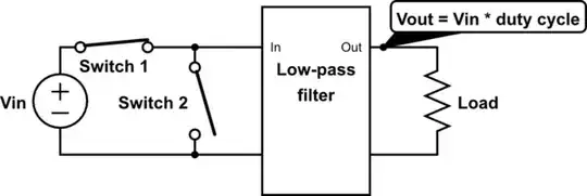

The PWM voltage is generated by switching a DC input voltage. When switch 1 is on, switch 2 is off, and vice-versa:
schematic
simulate this circuit

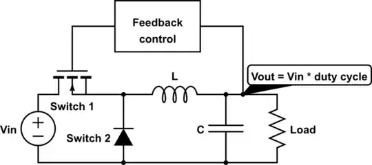

Finally, a feedback control system is added to compensate for component variation and improve the transient performance of the converter:
schematic
And that's a buck converter. A common variation is the synchronous buck converter, which replaces the diode with another MOSFET to reduce conduction losses. Practical converters may have other features such as overload protection or soft start-up.

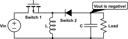

In a buck converter, the inductor is part of an L-C filter. But it's sometimes more helpful to think of it as an energy relay, especially when looking at other converter topologies. The basic idea is that when the MOSFET is on, the input voltage source stores energy in the inductor. When the MOSFET is off, the inductor releases that energy into the load. This is easiest to see in a buck-boost converter, where the input source and the load are never directly connected:
schematic
In all cases, the capacitor is there to smooth the output voltage. The inductor current is not constant, so without the capacitor the output voltage would vary during the switching cycle. (In buck and buck-boost converters, the inductor isn't even always connected to the load!) It's not a snubber since there's always a current path for the inductor.
