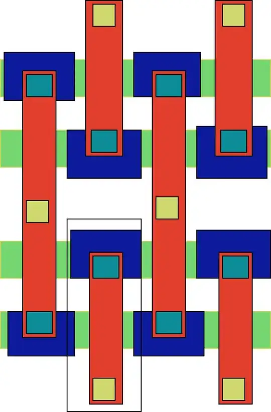

From the IC designer perspective, FLASH is much more expensive to make than DRAMs because I use more masks, and they take more area. I don't know where you got your area numbers, but I can believe that if you had a FLASH only process, I could tighten it up a bit. Of course, that would be expensive. You need to have a comparison that is uniform. I get a single bit of FLASH in the space that I get 8-bits of DRAM trench caps on a modern FinFET process. I've attached a picture of the DRAM layout for a 8-bit DRAM cell.
FLASH needs to not leak, and DRAM can be leaky so I don't need to worry about my oxide thickness or quality so much. Also, every time you program FLASH, you use hot electron injection that can cause oxide damage statically. The greater the VDS, the faster you program because of more hot-electrons, but the more risky you get a chance of having a hot-hole make an intermediate state, so you want thicker oxide.
Growing ticker oxide costs time for deposition, and therefore money, but just on your question: If you have a comparable process, I would expect the cost between FLASH and DRAM to be 8x for bit equivalence just on area. I expect that the discrepancy that you see between DRAM and FLASH is just process cost.

    You seem to be telling us why flash should cost more, when the situation is the reverse. – William Brodie-Tyrrell Jan 11 '16 at 02:36
    I have never used a FLASH-specific process; however, FLASH does cost more as far as Si wafer space/mask on the processes that I have used. Consumer pricing is a magical thing, and that's why I left it open ended. If you look at die costs at 0.05USD per 1mm^2, that's about the actual cost in silicon after mask setup. – b degnan Jan 11 '16 at 14:39
