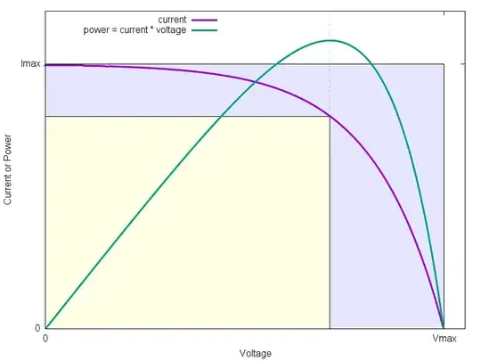

Unfortunately, it's not that easy.
If you connect different loads to a cell, the voltage and current through the load will (of course) be different. If you draw a curve of all that current vs. voltage points, it will look like the violet one on this picture:
If you measure the voltage with a multimeter (no other loads connected), no current is flowing through it, and you get Vmax.
If you measure the current only, you build a short circuit, so there is no voltage. This way, you measure Imax.
Now, just multiplying Vmax and Imax gives the light blue rectangle (partially overlapped by the yellow one). But this is no correct value because as said, the current at Vmax is zero, and so is the power!
If you take your measurements with the loads and draw a curve of (voltage * current) vs. voltage, you get the green curve. It shows what power is delivered by the cell at what voltage. You can clearly see there is a maximum, and the according power is the yellow rectangle.
So, the yellow rectangle shows the real maximum power, which is much smaller than what you calculate by Vmax*Imax.
I think you can measure Vmax and Imax for all your configurations of the cells, and it gives sort of hint which one gives the most power. But it may also be interesting to apply several different resistors and to this voltage and current measurement.

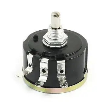

For your project, you could use a potentiometer, which looks like this: enter image description here
By turning the knob, you can change the resistance between one of the outer and the middle terminal. It would be best to have two multimeters, one to measure voltages and one to measure currents. Connect it like this, leaving one of the outer terminals unconnected:
schematic
and you can easily turn the knob a little, read current an voltage, and enter it into an excel sheet to generate curves similar to mine.
The potentiometer must be able to handle the maximum power your cells may deliver, which can be estimated by Imax * Vmax (per cell). I'm also not sure what resistance to recommend, may be you use two, one in the range of 100kOhm to 1MOhm, an one in the range of 1-10kOhm, to be able to measure with low and high loads. May be, you have someone to ask for this stuff, like a teacher?

    this is a good answer, but the use of small potentiometers as a load will be problematic except for the tiniest of solar panels. Most "pots" can dissipate about 0.1W at most unless you buy expensive wirewound versions which are good for a couple of watts. Even worse, when the pot is set to a small resistance, the power is dissipated in just a small part of its resistive track, e.g. if you have a 10 ohm 1W pot set to 1 ohm, then the most you can dissipate is 0.1W because you're using only 10% of the pot! – William Brodie-Tyrrell Jan 04 '16 at 22:37
    Instead of using a pot, the "right" answer is to use a test-load, e.g. google for "Re:load" and "Re:load Pro" for relatively-affordable options. – William Brodie-Tyrrell Jan 04 '16 at 22:38
