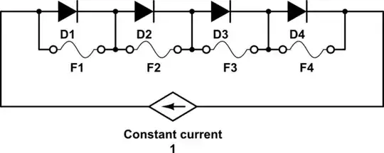

On the other side, it's strange that the fuse DID blow. We once saw the same weird behavior and did a test. We had four 1A fuses in series, each with a diode in parallel. This was connected to a constant current source of 1A, and the voltage drop over each fuse was monitored. As long as the fuses were OK, the voltage drop was far below 0.7V, and all the current went through the fuses. A blown fuse would be indicated by a voltage drop of about 0.7V:
schematic

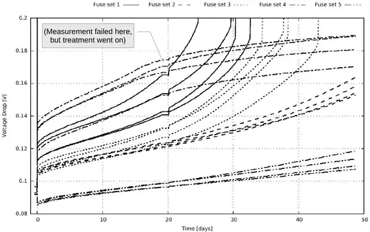

We put five of this sets equipped with fuses from different manufacturers and batches into an oven with a constant temperature of 85°C to add some stress and got this quite interesting result:
All fuses started to "age" immediately, as the slowly increasing voltage drop shows.
  • Set 1 has a high spread in voltage drop and the first fuse starts to increase the voltage drop at day 10 and finally blew 15 days later(!)
  • Set 3 is a different batch from the same manufacturer. It took longer, but the result is the same.
  • Set 4 started with a high voltage drop, but seemed to settle somewhere.
  • Set 2 starts with a low drop and the slope starts to increase at day ~25-30
  • Set 5 has a superior small voltage drop and really small part spread, but even here, the slope starts to increase very slowly around day 30. The price of this fuses is 3x the price of set 1 and 3...
(I have data for a longer period, but need to search it)
