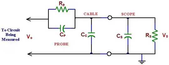

For a passive device the probe, the cable and the scope input have capacitance seen at the input: -

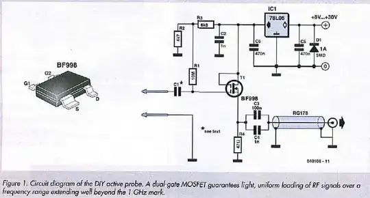

Here's a circuit of an active probe: -

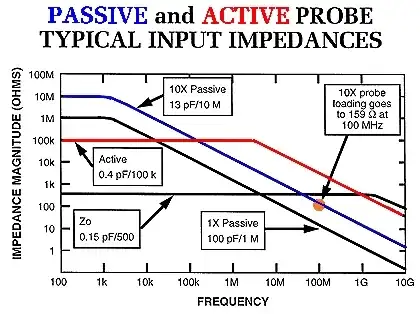

It uses a JFET (or MOSFET in the case above) to buffer the input. Here's a typical comparison between the probes: -

  • That Rp and Cp is coupled only in 10x case? and if 1x case there is no Rp Cp? WhatRoughBeast says upstairs "For 1x probes, the coax cable from the test probe to the scope has significant capacitance, and there is not capacitor in the probe". – user16307 Dec 30 '15 at 17:09
    @jjuserjr yes without the 10x bit on the end the capacitance can be 100pF (ish) as shown in my final diagram - note the 10x probe has an impedance that is 10x higher even at 100 MHz but it itself is rapidly becoming crappy at above 100 MHz whereas the active has a much bigger impedance and at over 1 GHz has the same impedance of a x1 at 10 MHz and a x10 at 100 MHz. – Andy aka Dec 30 '15 at 18:31
