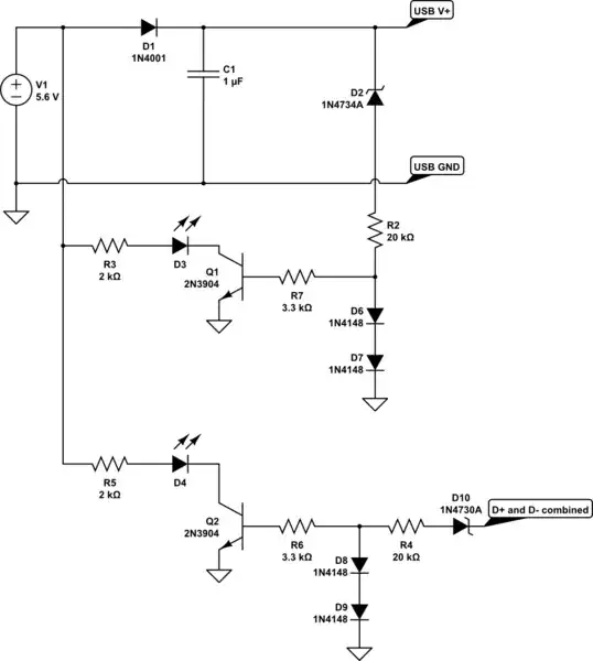

That said, here's your schematic for the destroyer detector:
schematic
If D3 flashes there are spikes higher than 6.5V on the USB VCC, if D4 flashes there are spikes higher than 4.5V on the USB data lines.
The 1N4148 diodes are only to protect against high energy spikes forcing an insane base current through the relatively modest 20k resistor, now that flows through those diodes first. Still a lot can break, of course, but this could be mass produced at the one or two dollar range, excluding the power source. If you see it as a discardable tool, you can leave out the 1N4148 diodes and the 3.3k resistors.
The 1N4007 protects the power source against spikes on the power up to several hundreds of volts (though if you expect those, remove the capacitor or get one rated for hundreds of volts, or that one might pop).
When the diodes flash faintly the "violation" is small (10V spikes or such), when it flashes brightly the spikes are high voltage and probably high energy.
But, of course, mass producing this is an absolute and utter waste of your money and I see this as a simple course of "You don't always need complicated electronics to detect things" tutorialing, rather than "here's a real problem that needs a real solution".

  • Thank you Asmyldof for a comprehensive and useful answer. Thanks to all who commented for an interesting discussion, especially to those who read my question carefully, and also followed the link. My statement "I would routinely test every USB device before using it" was a bit tongue-in-cheek -- for most USB sticks there would be good evidence that it is genuine: being new from a branded range; seeing it removed from a computer; or asking the donor to plug it in his own computer. A tester like the one described would be a last resort. – Harry Weston Dec 30 '15 at 17:27
  • This circuit does not help, if the USB Killer is a little bit more intelligent and activates the high voltage with a delay, or on an event (reading special block, or file). – Jonas Stein Nov 10 '18 at 13:47
