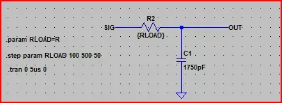

Running a simulation multiple times and changing multiple component values is a bit more involved than just changing one (which is not so bad)
Here is the concept for changing one value:
  • Add a .param statement using the SPICE directive icon on the far right, e.g. for a resistance value .param X=R
  • To use it you would enter {x} into the resistor value, then include e.g. .step param X 100 500 50 to step the value between 100 and 500 in increments of 50.
Example:

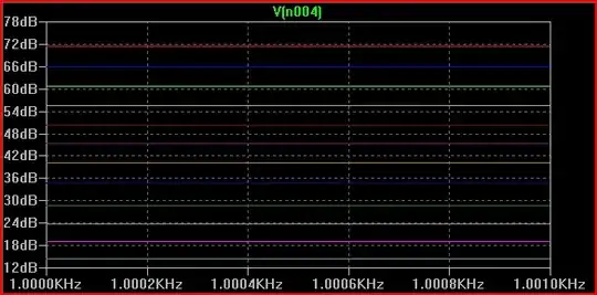

Result:
Graph

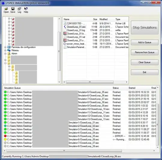

Have you tried "LTSpice Queue Manager"? (The link redirects to my own website where you can download the software but I'm not its author, who originally shared the program on a forum that is today closed. Sharing it through my website is a way to revive it).
This tool has been of much help to me in the past. You can prepare many simulation files and run them in a queue fashion.
LTSpice queue manager
