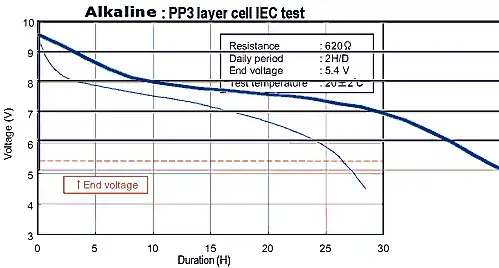

This, however does not mean that it will suit a specific target design. Here is an example of a discharge curve for a lightweight PP3 9V battery: -
Note that they define the end voltage and this means "end of test" because to drag more enrgy from the battery is going to either make it unsafe, unusable in 90% of target applications and render it impossible to recharge (if it were a rechargeable type). You have to set an end limit that is meaningful or you'd be conning the public.

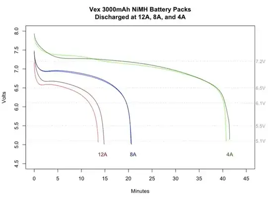

Will the area under a voltage vs. time graph of a battery discharge curve (with a constant current load) give the amp-hour capacity rating of the battery
[emphasis mine, N.A.]?
No. Not even close. Even units of measurement would not match.
Here's how to get Ah rating for the battery from voltage vs. time chart. One needs one more piece of information: discharge current. It's usually written on the chart.
enter image description here (source)
Let's say that the cutoff voltage for the battery in this chart is 6V. Under this voltage, we consider that the battery is depleted. At 8A discharge current, it will take roughly 20 minutes to discharge the battery down to 6V level. 8A * 0.3h = 2.4Ah (notice that the supplier advertised 3Ah).
