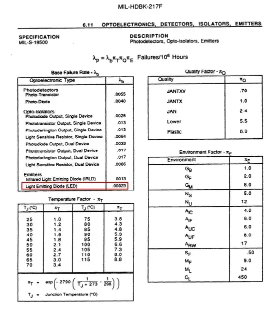

Let me open my trusty MIL-HDBK-217F and see what it says about LEDs and their longevity: -
The main factor affecting the failure rate per million hours is temperature.
Of interest, if I read the next section about laser diodes they do take into account duty cycle pulsing but their conclusion (on page 6-21) is that at 50:50 duty cycle the failure rate for laser diodes is about 25% of that when continually driven.
They also conclude (on page 6-22) that if you operate a laser diode at a light output power of 50% of its rating it will last ten times longer than operating it at 95% of it's rated output power.
Andy aka

  • This is fascinating, but I have to wonder how these base failure rates were derived. Why should "phototransistor", "photodiode", and "IRLED" fail far more often than "LED" (and none of them specified as to type or application)? What's the confidence interval on any of these values? Why is the temperature factor the same for all devices? This is not to disparage your answer at all--the source clearly says what it says. But I can't help thinking that these calculations--as worst-case values ca. 1991 under unspecified conditions--may only really be meaningful to the US military. – Oleksandr R. Dec 22 '15 at 01:08
  • @OleksandrR. have you since writing this comment done any research on the validity of the mil standard? – Andy aka Dec 22 '15 at 08:06
  • Unfortunately not. I don't know where to start, because nothing is mentioned in the document that would allow one to assess this. Actually, most of it looks completely sensible--but for these very similar devices with such small baseline failure rates, it seems likely that there is some unacknowledged application effect that skews the quoted values. If IRLEDs are high-luminance ones used in IR illuminators, for example. And opto-isolators could easily be failing due to current or voltage stress rather than the LEDs burning out--thus why the phototransistor output ones fail more often. – Oleksandr R. Dec 22 '15 at 10:03
    Excuse me. I just saw there is a references section at the end. The LEDs are described in RADC-TR-88-97, where it is noted that just 22 LEDs failed over 4827 million hours of operation, and zero (!) IRLEDs failed over 39 million hours. With such small (or nonexistent) sample sizes, the reason for the odd values is clear. RADC-TR-88-97 also goes into detail about the statistical methods and results. Overall it seems to be a far more meaningful document than MIL-HDBK-217F. – Oleksandr R. Dec 22 '15 at 10:16
  • @OleksandrR. maybe consider making this an answer? – Andy aka Dec 22 '15 at 10:33
