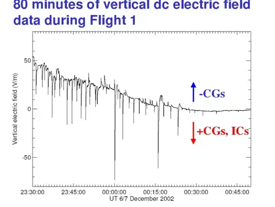

Well... According to this question I just asked about rectification, trying to measure the voltage or the "E Field" this method will not work, and we need a field mill. The problem with a field mill, however is the weight, and power consumption. We are limited to 800 Grams on this flight, and I don't know if a field mill will fulfill that requirement.
What is a good strategy to measure what we are trying to do? This PDF has some interesting measurements with electric field, I don't know how they did it, however.

Detecting the voltage with a static pickup is nearly impossible because just about any means to measure the voltage will have lower impedance than two electrodes sitting in air. Even a really high impedance voltmeter will bleed off charge without it collecting.
The trick is to keep flipping the electrodes mechanically and look at the amplitude of the AC signal. This is what a field mill does. It's usually two electrodes on a spinning cylinder, and is how electric field strength of air for purposes like lightning research is measured. I expect you'll find lots of info using "field mill lightning" as a search term.
Try that, then come back here if you have more questions.
