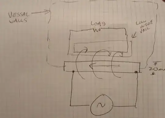

This is certainly possible.
Since you do not list any efficiency requirements, one solution might be to drive an AC current across (not though) the stainless steel, and use a pickup inside the vessel to inductively generate power inside the vessel. The coil does not touch the stainless steel wall.
Here I am showing the half of the AC where the current if flowing from left to right across a wall of the vessel (the arrow pointing left). This generates the circular magnetic field lines around the path of the current though the stainless steel wall.
You would position the interior pickup coil so that these circular field lines cut though it as the get bigger and smaller (the coil is parallel with the path of the current in the wall).
You would pick the number of turns for the interior coil based on the volts/amps you need inside the vessel.
Think of it as a transformer where the primary (the stainless) has 1 turn.
If you need DC inside the vacuum, then you'd need to rectify and filter the power coming off the interior coil.
There are many ways you could potentially make this arrangement more practical, but they are dependent on the geometry of your setup.
