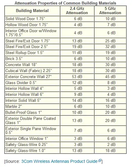

Some WiFi units may specify a slightly higher figure but it's all down to understanding their assumptions about the bit error rate that they judged to be acceptable. Here's a useful table: -
Stolen from this website and please note the theoretical free space ranges quoted have got feet and meters mixed up.
Some of the figures in the table above assume different packet error rates than others i.e. the 11Mbps data rate should theoretically require -83.6 dBm but the table specifies -90 dBm. Also different modulation schemes can introduce a variability in the value. See this page for a few more pointers: -
