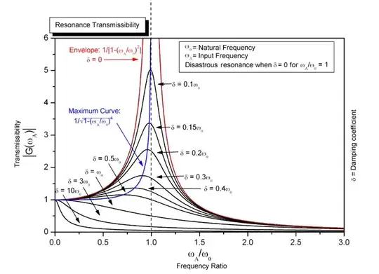

The receiver has an inductive pickup which is tuned to resonate at the transmit frequency, which very greatly increases the available voltage levels.
Graph: Increase of amplitude as damping decreases and frequency appro aches resonant frequency of a damped simple harmonic oscillator. From Wikipedia resonance page
The fields generated are significant and MAY cause problems in some equipment but in most cases will not have any effect on untuned circuitry. The most likely effect would be audio pickup in audio circuits if the equipment is used while charging - but in almost all cases the equipment will not be used when on the charging "mat".
