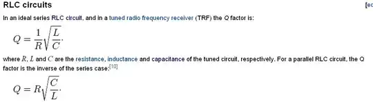

The achievable range relates to the "Q" of the tuned circuit. If the circuit has high Q the receiver voltages will be higher but the tuning range will be narrower. I was able to achieve acceptable Q for ranges of mm to a cm with 5% mylar capacitors and coils hand wound to the same number of turns on ferrite U cores. If you are prepared to tune the receivers or to use more precision components then higher Q's are possible.
Wikipedia on Q - good
Notes section headed RLC circuits near the bottom - but read the rest as well.

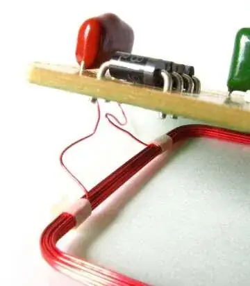

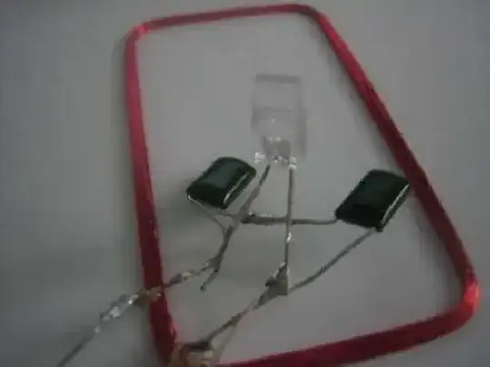

I have NOT gone over any of the following in detail. They are examples of what's involved. Most people use a full bridge driver driving a resonant coil BUT a single transistor oscillator with a class-C power stage may be as good.
Instructables (agh) but may be OK as a concept proof.
At a glance this looks good even though he says he's having problems
This is his transmitter circuit - gives a general idea of what can be involved. The 2 x 10 ohm resistors form a half bridge driver but limit his power and waste power.
These people think they are serious - looks OK

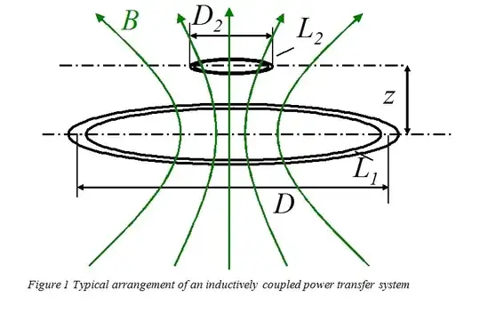

  • The basic principle of an inductively coupled power transfer system is shown in Figure 1. It consist of a transmitter coil L1 and a receiver coil L2. Both coils form a system of magnetically coupled inductors. An alternating current in the transmitter coil generates a magnetic field which induces a voltage in the receiver coil. This voltage can be used to power a mobile device or charge a battery.
    The efficiency of the power transfer depends on the coupling (k) between the inductors and their quality (Q). (See also Figure of merit)
    The coupling is determined by the distance between the inductors (z) and the relative size (D2 /D). The coupling is further determined by the shape of the coils and the angle between them (not shown).
