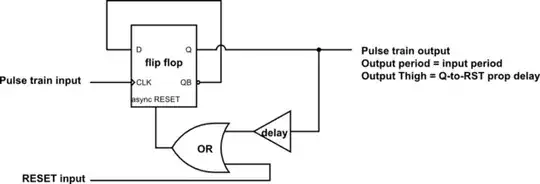

One way to do this is using:
  • An edge-triggered flip-flop with asynchronous reset
  • A delay circuit (could just be an RC filter, possibly followed by a schmitt trigger).
configured as follows:
schematic
The delay time will define the output high pulse width, so it needs to be selected to be narrow enough to not interfere with the next period, but wide enough to be detected.
There are probably already ICs that contain this circuitry, but I'm more familiar with IC design, so this solution is the first one that came to my mind.
