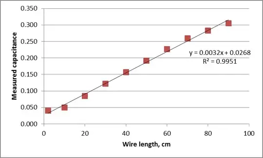

I wanted to use an Arduino as a capacitance measurement device for a coaxial wire. I started at measuring the wire capacitance using digital multi-meter UT58B. I turned the knob to 2 nF and then measured the capacitance depending on the wire length. These are the results:
Results for capacitance measurements
After the measurements I got the function (y = 0.0032x + 0.0268) on how the capacity changes depending on wire length. Now I wanted to use the Arduino to measure the capacitance and then calculate the wire length depending on the capacity. I tried following a guide to make the Arduino be able to measure the capacity.

  • @Oliver On the graph are the values my multi-meter showed when it had the knob on 2nF position. So the units are nF if I am correct. – disoderly Dec 04 '15 at 13:08
  • @disoderly Then yes, the units and nF which means your range of interest is something like 50pF to 350pF. Tricky. Your meter is unlikely to read accurately down in the pF range, it typically needs dedicated equipment. The test leads on the meter are going to be 50pF at least. – Oliver Dec 04 '15 at 13:13

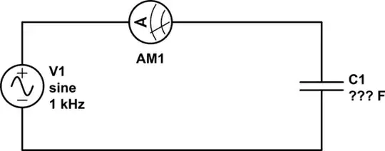

Now, what does a multimeter or RLC meter do? Simplified something like this:
schematic
It knows it makes a 1kHz sine function at a certain voltage, so it measures the current that flows into the capacitor, then if it is sure about the voltage (either by strong drivers of the sine signal, or by measuring that as well), it can calculate an effective AC resistance and from the formula above it will turn that into capacitance.

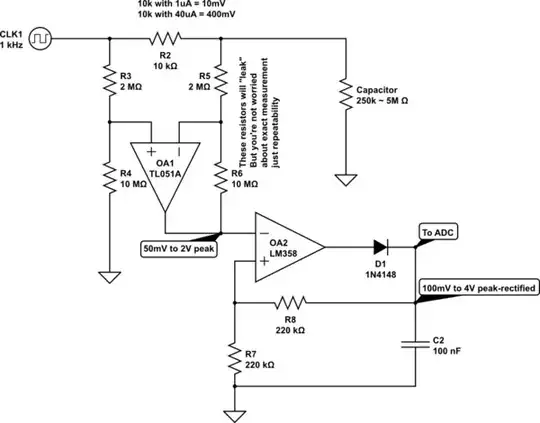

But that's all not very relevant for you, what you probably should do, to make it as easy as possible, is create a frequency, possibly with a timer output on the Arduino and record what current flows through the cable's capacitance at what length, and just create a new formula for that, as that involves much fewer steps and calculations and calibrations than first getting the capacitance right and then transforming that.
To be able to estimate what we need, we should calculate the apparent resistance of your limiting values. From your graph it's 50pF to 350pF, so we'll take some room and make it 25pF to 500pF. So we calculate with the simplified equation I gave earlier, I'll assume 1kHz, since that allows you to adjust to 100Hz and 10kHz if needed:
"R(25pF)" = 1 / (2*pi*1000Hz * 25pF) =~ 6.37M Ohm
"R(500pF)" = 1 / (2*pi*1000Hz * 500pF) =~ 318k Ohm
Now, this assumes a sine wave, and you will most likely be making a square wave, which contains many higher frequencies, which will decrease those figures. Assuming you are using 5V, we can pretty safely say your measurement will be between 1μA and 40μA peak.
Now we need to find a trick to turn 1μA to 40μA into something your Arduino can measure. Here we go:
schematic
simulate this circuit
The first op-amp is a difference amplifier with a gain of 5. You can have 10 gain there as well, but if you add the rectifier to that stage, your leakage path will include a capacitor, and that may give you trouble when you decide to start playing with the frequency.
The first op-amp amplifies the difference across the resistor of 10k by 5, because it wants the + voltage to be on the - side. At a high going flank of your signal it will see a difference based on the current, in the positive direction. At a low going flank it will see the opposite, so it will try to create a negative voltage. Fortunately powered by +5V and ground it can't do that.
The second op-amp takes the positive pulses and amplifies them by 2 through a diode. The diode makes sure the capacitor can only be charged by the pulses and discharged by the feedback loop of R7 + R8. So the discharging of the 100nF capacitor has a time constant of about 0.44seconds to discharge to about 37%, that gives you a bit of slowness, but will get you a good rectification for 100Hz to 10kHz signals. The charging may also take a little time, because the op-amp may not be able to fully charge the capacitor the first few pulses, but I don't think you will notice that difference much.
If you need it all to be faster you can decrease the capacitor a little, just be sure the discharging RC-constant (R value times C value) is less than 1/5th the source frequency you end up using.
I chose the TL051A because it has a nice and low input bias current, low input offset voltage (less than 1mV) and a good output slew rate (20V/μs) as well as a unity gain bandwidth more than 50 times the highest frequency we were considering. Another important thing here is the fact that its inputs can go all the way up to its power supply. They don't give good results at the negative rail (so when the pulse is steady off), but from its internal schematic I expect the output to remain close enough to 0 to not be much of a bother.
It is available at farnell for about €1,- in SMD and DIP packages, so it's quite suited for hobby work. I tried searching Digikey, but the search function didn't work.
Here's the TL051A datasheet.
For the second op-amp it's important it's able to go to the 0V at the input, or at least close to it, and since the signal is already amplified a lot, input offset voltage can be a bit higher and input offset current and bias current are not that relevant, so a standard LM358 type might be suitable. Although it is possible it will give a little distortion on the highest output voltages, I expect that to be limited.
Here's the LM358N datasheet
Now you can sample a 0.1V to 4V signal to determine the measure capacitance leakage. With a 10bit ADC running on 5V you have a bit-resolution of about 5mV per LSB, so you should be able to measure quite accurately.
