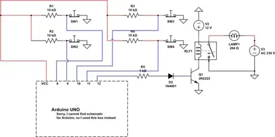

I have created a very simple circuit using arduino, in which I have 4 switches used to control the lamp ON/OFF as shown in the below schematic.
schematic

Basically, my original project has a Motor instead of Lamp, & the four switches shown above are the two pairs of switches in each tank. i.e. I have two tanks and two switches in each tank. 1 switch at the bottom of the tank to measure the water level. If tank is empty then this switch will be open. Another switch at the top of the tank, which will verify that if the tank is full or not and accordingly it will turn on/off the valve which is not shown in the below diagrams, as I think it's not necessary now.

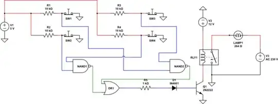

The above circuit works perfectly, but now I want to complete the same circuit using logic gates, instead of arduino. I have tried the circuit shown in below schematic, but I was not successful as I am new to electronics & Logic gates.
schematic
simulate this circuit
I want to use logic gates instead of Arduino to bring down the cost.

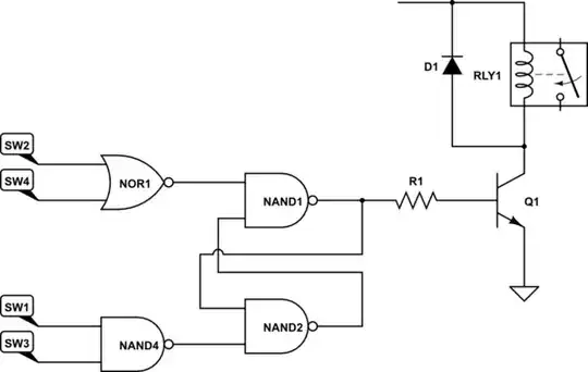

In this case, as @on8tom has pointed out, you need some sort of storage device, and a set/reset flip-flop is an excellent choice. Then
schematic
simulate this circuit – Schematic created using CircuitLab should do what you want. Note that I've added a flyback diode on the relay coil, and you should always do this. The diode should be rated for more current than the relay coil draws.

  • Yes, that was a typing mistake. I have my code on another HDD & at the time of asking this question, i was not having access to the HDD, so I typed the code here, anyways I will just edit it. Thank you for the above diagram. But I am not able to calculate things because of the inputs of nand1 and nand2 are complicated. Still I will try to learn calculating logic gates. I would verify your answer & then I will tell you if I have any problems. – Vishal Nov 25 '15 at 06:21
  • The logic isn't hard if you approach it right. Assume the tanks are filling, and both are halfway full. Then all switches are closed, and you can see the state of the SR easily. Then change one of the FULL switches, and trace the effects. – WhatRoughBeast Nov 25 '15 at 15:10
