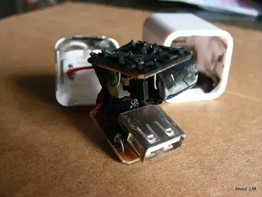

Short answer is: its possible.
There is a famous case about a woman who died after answering her phone. Reportedly it was a fake chargers fault.
Take a look at this article reviewing different chargers.
Note that many cheap chargers do not respect regulations and recommendations needed for safety certification.
If you take the right precautions and use decent gear you will be much safer though and shouldnt worry.

The adaptor is supposed to be insulated to prevent this, even in the case of internal failure. The only circumstance it could go wrong is if it's an illegally sold one with false CE/UL certification.
