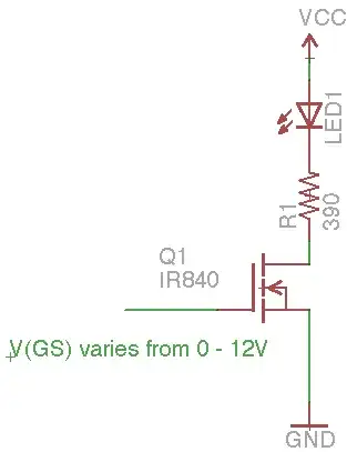

MOSFETs allow current to flow from their drain to source when there is "enough" voltage present at the gate - this voltage is reference to the MOSFET's source. This "enough" voltage is formally known as the Threshold voltage. When the voltage at the gate exceeds the threshold voltage of the MOSFET, the MOSFET is said to be on. Note that the threshold voltage is referenced to source. Keep this in mind as sometimes the source is not connected to ground.
In the following circuit when the voltage at the gate, V(GS), is higher than the threshold voltage the LED will turn on.
This is because when the MOSFET is off, it has a very high resistance between its drain and source. Think of this as a switch in the open position. In this case, most of the voltage from the supply also drops on the MOSFET itself.
If you increase V(GS) slowly starting from 0V, you'll notice that at a certain value the LED lights up. That is your threshold voltage. If you keep increasing your V(GS), the LED will increase in brightness - this is because the MOSFET's resistance is dropping and it's allowing more and more current to pass. Eventually, you'll notice that the LED brightness does not increase no matter how much you increase V(GS). This is because the MOSFET's resistance no longer determines the current (it's your 390 Ohm resistor).
If you increase V(GS) to some large value, like, say 12V you'll notice that now most of the voltage now drops across the 390 Ohm resistor and around 2V is dropped on the LED. This is because the MOSFET's resistance is almost zero now and it's now operating in the linear region.
