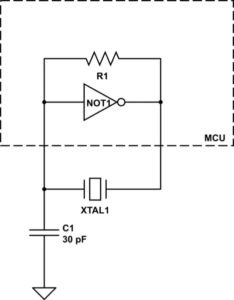

I'm trying to pick a crystal and capacitors for the clocking of a MCU, and, from what I've understood, my crystal needs a load capacitance of 30pF (it's specified in the datasheet) in order to properly work. The way I'd have done this would be:
schematic

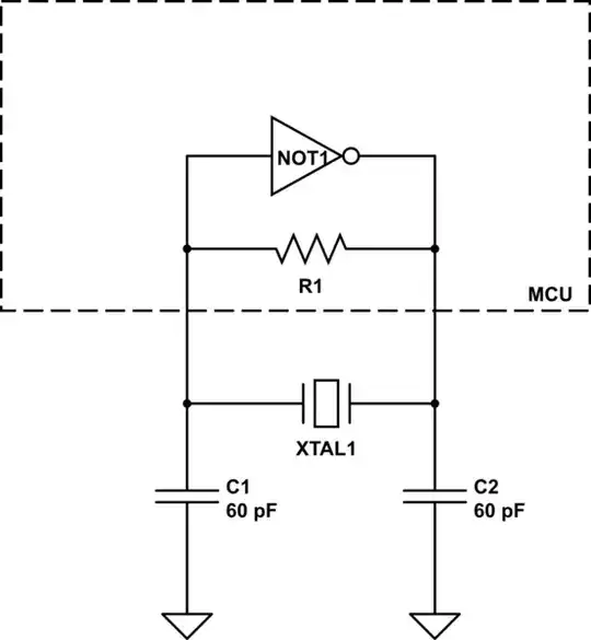

However, everyone is telling me I should do this:
schematic
simulate this circuit
Because the capacitors are, somehow, in series. This makes zero sense to me: I'm using one more capacitor, and the capacitor in the right side is next to the low-impedance output of the inverter, so I just don't see it in series. Also, my design uses one less capacitor. What am I missing?

There are two aspects of load capacitance. What the crystal sees is the capacitance between the two ends of the crystal. Typically the oscillator circuit will need some capacitance between one end of the crystal and ground, but that's of less importance to the crystal.
If the two ends of the crystal were moving up and down in perfect anti-phase fashion, and two load capacitors were sized according to the inverse ratio of the amplitudes, then current flowing from one capacitor into ground would precisely match current flowing from ground into the other capacitor, such that if one disconnected ground but left the capacitors connected to each other, circuit operation would be unaffected. In that situation it would be obvious why the series value of the capacitance would matter, because the only capacitance involved would be two capacitors, in series.
In practice the two ends of the crystal don't oscillate quite 180 degrees apart, and the capacitors aren't sized to match the amplitude ratio, so there's a little ground current flowing in the caps, but it's generally only a small portion of the total cap current, so the dominant behavior is still that of the two caps in series.
supercat
  • 46,736
  • 87
  • 148
  • Why does the current that goes through C2 matter at all? Shouldn't the inverter be able to source this current? – FrancoVS Nov 06 '15 at 21:59
    @FrancoVS: In an oscillator circuit, the inverter will be designed to have a very limited output current; if the inverter were not thus limited, it would be necessary to add a resistor in series. Use an inverter with high-current outputs and no resistor would likely cause premature crystal failure. – supercat Nov 06 '15 at 22:03
  • ah, that explains the series thing. But why not just use one 30pF cap across the crystal then? – FrancoVS Nov 06 '15 at 22:15
    @FrancoVS: If there weren't any capacitance to ground and the inverter had a range of input voltages which caused the output to neither source nor sink current, then whenever the input was at such a voltage both ends of the crystal would be floating. One could probably place one cap in parallel with the crystal and put a second cap to ground at one end of it, but using a properly-sized pair of capacitors in the usual fashion will be more efficient. – supercat Nov 07 '15 at 00:20

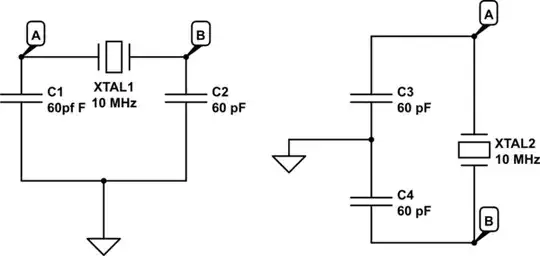

Rotating this schematic shows why you can consider the capacitance across the crystal to be interpreted as in series. The load is measured across the XTAL and not relative to ground

  • why do crystal datasheets specify a "load capacitance" that, according to you, is only half of the actual load capacitance? Also, wouldn't C2 (in my drawing) be dependent on the series resistance of the inverter? – FrancoVS Nov 07 '15 at 12:10
  • @FrancoVS I'm not saying that - my assertion is that the load capacitance is what appears in your first diagram (C1). C2 is somewhat dependant on the internals of the inverter but I don't see how this is related to how the xtal is loaded. – Andy aka Nov 07 '15 at 12:17
  • my point is that most tutorials I read are telling me that a good way to specify C1 and C2 is by assuming they are equal, and that I should specify them such that their series capacitance is equal to the "load capacitance" value on the crystal's datasheet (ignoring the board's capacitance). If I understand correctly what you are saying, this is wrong: C1 is the load capacitor (therefore, I am presenting 60pF to a crystal that expects 30pF), and C2 doesn't depend on the crystal at all: it should be specified according to the inverter. – FrancoVS Nov 07 '15 at 13:12
  • @FrancoVS I hear exactly what you say and it seems that all the commonplace tutorials on xtals split the capacitance either side and usually equally. Well, as far as my analysis goes, the driven end of the xtal is, a few handful of ohms or tens of ohms. Let's say 50 ohms max. Now look at the impedance of a 22pF just on the input side of the buffer. At (say) 10MHz the impedance is 723 ohms. What this tells me is that the load on the xtal is the 22pF in series with 50 ohms. Putting another 22pF on the output is just shunting the 50 ohms a bit. – Andy aka Nov 07 '15 at 13:24
  • Of course all of this assumes that the equivalent circuit of the xtal supplied by manufacturer's data sheets is precise around the operating frequency. Nothing in my experience leads me to believe that the cap on the inverter output is there for anything else other than shaping the output waveform to make it "easier" on the delicate little xtal. – Andy aka Nov 07 '15 at 13:27
