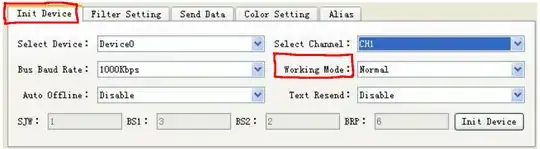

All of the symptoms are consistent with the USB-CAN monitor operating in listen-only mode (not participating actively on the CAN bus). Or not understanding 29-bit messages, but that is unlikely (J1939 is explicitly listed).
From page 10 in the manual (bizarrely packed into a ZIP file), Ginkgo USB-CAN Interface VTG203B User Manual v1.1:
In tab Init Device, Working Mode should be "Normal". If it is "Silent mode" (or just "Silent"?) or perhaps some of the loopback modes, it would explain what you are observing.
Screenshot of the place to set the mode, e.g. listen-only
