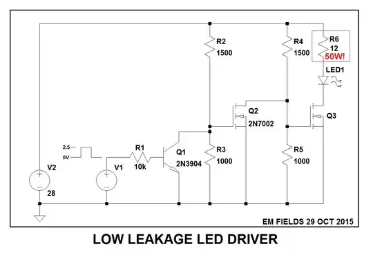

The implication, since you indicate that the input is a digital signal, is that you want to either turn the LED ON or OFF.
If that's true, why don't you ditch the opamp and use something like what's shown below to drive the LED?
First transistor inverts the input signal, the second one gets very close to zero volts to hard turn off the third one, which drives the LED ON when the input signal is high.
Here's the LTspice circuit list if you want to play with the circuit. I chose Q3 and the LED from LTspice's component library without getting the manufacturter's data sheets, so there may be a better fit if you choose to look for it.

Whoa, that's a lot of dissipation! At 2.5 V in, there will be 5 A thru the resistor, transistor, and LED. That's 12.5 W into the resistor alone. Overall the supply will have to source 140 W with the LED getting maybe 15 W or so depending on actual forward voltage. Not only is this horribly inefficient, but the FET will take the bulk of the abuse. With the resistor dropping 2.5 V and the LED dropping let's say 3 V, that leaves 22.5 V across the FET. That times 5 A is 113 W.
A high voltage like 28 V is totally inappropriate here. It should be just a little above what will appear across the resistor and the LED, maybe 6 V in this case. Also in this case I'd use a lower current sense resistor that doesn't burn up 2.5 V.
To answer the question, you get around the offset voltage of the opamp by adding a little bias to the negative input. It sounds like you have a regulated supply available in this circuit. Let's say that's 3.3 V. You say the opamp's offset can be 500 µV, so a 3.3 kΩ resistor between the 3.3 V supply and the opamp negative input should do it. I'd probably make it a little smaller for a little margin if having the LED totally off is really that important.
