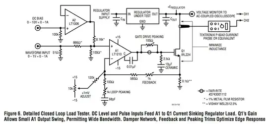

I've been working with op amp circuits on nights and weekends for about a year now. It was a fair amount of time before I encountered a current feedback op amp (CFA) even by mention, and only now that I come across one in an actual circuit I'm studying (LT1210 on page 3).

  • Driving Capacitive loads. Reference your question Figure 6., note the heavy duty snubber at the FET gate.
