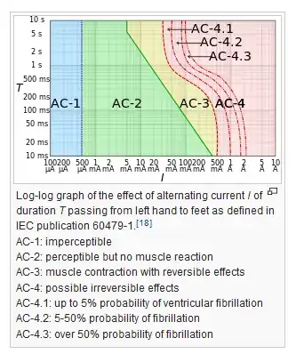

If we refer to Wiki- Electricity Shock we can determine how much current in how much time cause damage to body.
As you see in case of this current you are always in green part of diagram.
If you touch your tongue, it's resistance will be hundred of ohms. then it's current will be tens of mA. According to this figure if you hold it for more than a second, it will cause you an AS-3 kind of damage, that it's not so serious indeed.

  • I'm not sure how relevant that diagram is since he's asking about DC. – the gods from engineering Oct 26 '15 at 11:19
  • @RespawnedFluff : If you read the article, it say an AC current harm more than a DC one. DC current sides effect is between 2 to 10 times less than a AC current according to mentioned source. Then I attach a high risky diagram that was included in article, since it cover DC current stimulus also. – HOPE Oct 26 '15 at 11:25
