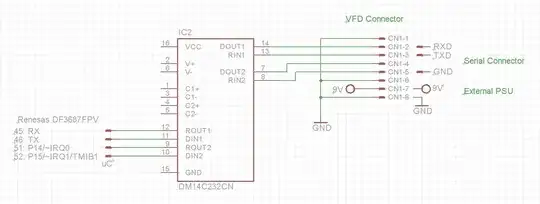

I figured out that the VFD boards use RS-232 thanks to a DS14C232CM level shifter right next to the main connector. Some prodding with a continuity tester later and I came up with this schematic and testing setup:
The second pair of lines looks to be used for flow control.

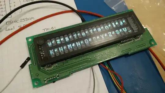

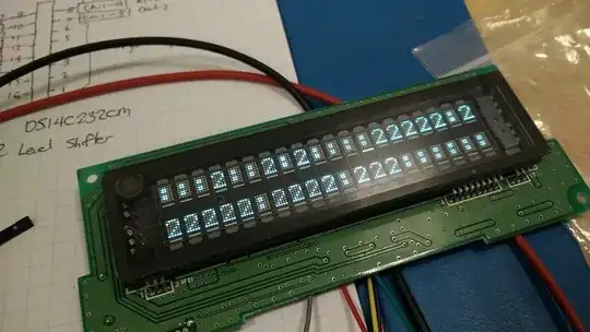

The interface is a standard RS232 terminal with some display control done via escape codes. I tried using a USB-RS232 adapter to send some characters to it using RealTerm, but here's my issue: some characters display reliably, while others show consistent flipped bit errors. Here's an example, I'm sending lots of '2's to the screen:
'2' is ASCII 0x32 or 0b00110010. ':' is 0x3A or 0b0011*1*010. Bit 3 is flipped. Similarly when I send 1, I almost exclusively get 9; same bit 3 error. Printing : or 9 displays reliably. This is what printing the alphabet looks like:
I swapped in a second screen and it too has similar problem. Printing f results in an occasional 'v' or 'd'. Other characters have other issues.

  • I compared the alphabet printout to the characters sent and there wasn't anything consistent throughout. The characters that got printed lowercase instead of uppercase (e,f,g) have a difference of 32. L, which printed as N, has a difference of 2. A and B, which get printed as y and z, are different by 56. Space, which gets printed as ┘, is off by 185. But it's all the same every time I try to print them, though. – BB ON Oct 15 '15 at 03:27
