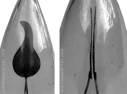

"Flicker Flame" bulbs are really neon glow bulbs with specially shaped electrodes.
They are bulbs because the neon (with usually a little argon) must be kept pure and at low pressure. See Electric discharge in gases at Wikipedia.

They flicker mostly because of Paschen's Law:
  1. The breakdown and glow voltage depends on electrode separation.
  2. The breakdown and glow voltage depends on the pressure/density of the gas.
So, as the gas near one part of an electrode glows, it heats up -- changing its localized breakdown voltage and allowing the "flame" to move different parts of the electrodes.
Similarly, varying the electrode separation gap can encourage motion.
From Unstable cathode-glow and the flickering flame-effect neon:
Electrode spacing increases towards the top in this example. This gives a rising-effect in the motion of the glow spot.
Artful electrode arrangement
