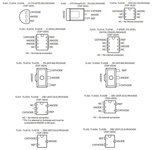

There are of course different packages in which one such IC can be sold. A great example is TL431, which only needs 3 pins, but is sold in a variety of packages to suit customer demands (up to 8 pins). You'll see in the image below that in some packages several pins are used for a given function (duplicated) to increase allowable current etc. So that's one alternative for "NC".

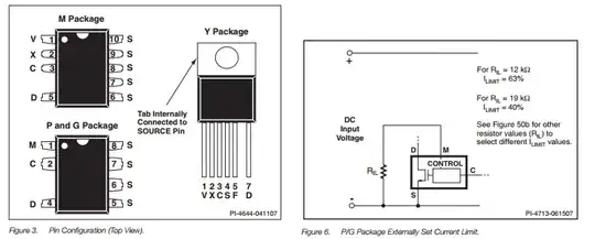

Here's another (perhaps even more interesting) example, the TOP254 which is both an example of pin duplication, and of the [rare] pin removal (in the DIP package[s]). The duplication is again done for the same reasons mentioned before. The pin removal between C and D is to increase safety by maximizing distance (creepage and clearance). This an SMPS controller with integrated main switch. Between its D pin and everything else you [periodically] have hundreds of volts of rectified mains voltage. The datasheet even lists this among its features:
Extended creepage between DRAIN and all other pins improves field reliability
