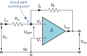

I can't find any source online which explains this in a different way from the others. I'd like to think I'm not just being slow, but it seems that I might be just that, regarding the op-amplifier.
So the summing-point constraint claims that \$x\rightarrow 0\$, if we assume the op-amplifier to be ideal. To me, this makes no sense when you consider the characteristics of an ideal op-amplifier.
Suppose that, due to \$V_{in}\$, a positive voltage \$V_{DIFF}\$ appears at the inverting input. Then a large negative output voltage result at the output.
\$V_{OUT}\rightarrow-\infty\$
(Here's where I don't agree with explanations anymore)
A fraction of this is sent back through \$R_F\$, meaning that \$V_{DIFF}\rightarrow 0\$ with time.
I just don't get this, if I were to use numbers to explain why I'm confused, suppose that \$V_{DIFF} = 0.1\,v\$ initially, and then \$V_{OUT}=-10\,000\,v\$. If a fraction of this is sent back, say \$0.1\%\$. Then the voltage \$V_{DIFF}=0.1+0.001\cdot V_{OUT}=-9.9\,V\$
And it continues to spiral out of control. How does it really work? Why does \$V_{DIFF}\rightarrow 0\$?
The "fraction" that is sent back is not really a voltage, it's a current.
If \$V_{OUT}\$ is -10,000 V, then there must flow through \$R_F\$ a current of \$\frac{10^4}{R_F}\mathrm{A}\$. Since the input impedance of the op-amp is very high (infinite in the ideal case), the resulting feedback voltage at the inverting input is determined by a voltage divider between \$R_F\$ and \$R_{in}\$. So the feedback voltage is \$V_{OUT}\frac{R_{in}}{R_F+R_{in}}\$. It's likely to be much higher than the 0.1% you assumed in your example.
How to solve for the output voltage including the forward gain and feedback terms, is explained in a previous question.

B.Lee - for answering your question you need to fully understand the "secrets" of negative feedback. Let me try to explain using a simple example:
Let us analyze what happens after switch-on the power supplies +/- Vs=+/-10V. (The described timely sequence may be somewhat „formalistic“ - however, it helps to understand the feedback concept).
Example: Non-inverting gain stage with desired gain of "+2". That means: Feedback factor k=0.5. Open-loop gain: Aol=1E4.
1.) t=0: Apply at an input voltage Vin=1V. The opamp is not yet working in its linear range (feedback not yet active due to time constants within the circuit) and the output will immediately jump to Vs=+10V.
2.) t>0: The voltage at the inverting terminal will rise to 0.5Vs=5V>Vin=1V. Hence, the voltage at this inverting terminal dominates (is larger) and the output voltage will change in the direction to minus 10V.
3.) However, on its way to -10V the ouput voltage is crossing a positive value which produces at the inverting terminal a feedback voltage of +0.99980004V .
4.) At this very moment (assuming an open-loop gain Aol=1E4) , the opamp is in its linear amplification region because the diff. voltage is Vdiff=Vin-0.99980004=1-0.99980004=0.00019996V. As a result, the output voltage is Vout=Vdiff*Aol=0.00019996*1E4=1.9996001V.
5.) This is a stable equilibrium because: the classical feedback formula for a finite value of Aol also gives the output voltage Vout=Vin*[1E4/(1+0.5E4)]=1.9996001 V.
6.) That means: We have an equilibrium because the output voltage has a value which exactly meets the condition Vout=Vdiff*Aol. Any larger/smaller output voltage causes a small reduction/increase for Vdiff thereby correcting this deviation from the equilibrium.
7.) In this example, the input difference voltage, of course, is NOT zero. It never will be zero - however, the diff. voltage is so small (in our case app. 0.2mV) that it can be neglected (assumed to be zero for calculations) in many cases.

One way of looking at this is the Op-Amp's output voltage (in this inverting stage) is always kept at a value such that the current through Rin is the same as the current through Rf whilst keeping the junction at virtual earth potential. If the input impedance of the op-amp is very high (it can be ignored) then Vin/Rin must be very close to -Vout/Rf. This really avoids the issue of voltages being higher than power supply limits as the balance is a continuous process (and therefore doesn't spiral out of control)
