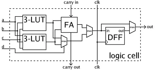

FPGAs consists of a number of "Logic Blocks", which can have things such as look-up-tables, registers (flop-flops) and usually some other logic, that enables them to be easily configured to commonly used elements, such as adders. The logic blocks have a few switches inside them that can disable certain elements (eg. the flip-flop). This and the look up table for the LUT is configured by the bit-stream. You can see a simple Logic Block here:
A sketch of a simple Logic Block from wiki
The FPGA might also have some special Logic Blocks, like multiplication blocks, output blocks, clock management blocks, etc.
The inputs and outputs of the Logic Blocks are connected through a number of programmable interconnections, or as you say " a giant array of switches", except that the size of the array has been minimized, so that only Logic Blocks close to each other (on the same bus) can connect. Usually there will be interconnections where buses can connect directly, but it is not uncommon that routing through a LB is necessary.
Being able to reconfigure the "switches" in the LBs and re-configuring the programmable interconnections, ether at "boot" or in some instances during run time, i exactly what makes the gate array field programmable.
While searching for images i stumbled on this good description on the internal workings of an FPGA.
