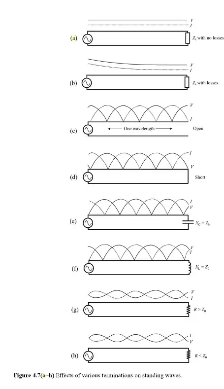

The [distributed] capacitance is said to disappear in the sense that there are no standing waves when a transmission line is terminated in a resistor that equals the characteristic impedance of the line. In that case, V and I along the line look like in the 1st (or 2nd) graph[s] below, i.e. they are always in phase. The difference between these first two is whether the line has any resistive losses. This is the "magic" that Horowitz is talking about, i.e. V and I along the line look as if the line is purely resistive when properly terminated.
You can see that in the subsequent graphs V and I along the line are never always in phase (i.e. there's a capacitive/inductive effect), even if the line is terminated with a resistor, but of a different value than the line's characteristic impedance. Furthermore, in all graphs but the first two, there are minimima and maxima along the line. It's these minima and maxima that Horowitz was talking about (in the case of an open-ended cable) prior to his "magic" remark. More precisely he was talking about how varying the generator's signal frequency results in different amplitudes measured at the far end of the cable, which is not hard to see from the 3rd graph below could happen. Then he talks about how adding a matching terminator makes the signal snap back from [a] zero as if magic happens.
The calculations proving this happens (actual "why") are a bit involved. I suggest you consult a[ny] textbook dealing with transmission lines, including the one from which I borrowed this image. Actually Wikipedia has the derivations too, but it's not the most mathematically clear presentation I saw (and its illustrations in this case are rather lackluster).
