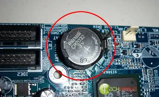

They use a small backup battery, which you can read about on Wikipedia:
Modern personal computer motherboards have a backup battery to run the real-time clock circuit and retain configuration memory while the system is turned off.
In computers this is usually called the "BIOS battery" and is generally a lithium cell such as a CR2032. In the photo below it is circled in red:
BIOS backup battery
This is the same for portable devices which have their own battery, for example a laptop. You can prove this by removing the internal battery and seeing if it keeps the time.
So to answer your question they don't really keep time without power, they have a battery for it.

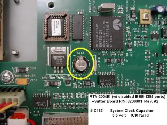

Modern equipment often uses ultra-capacitors to keep real-time clock powered when the system is off:
This is a typical solution for most mobile phones which are almost constantly powered and only need the back-up power when the user removes the battery.
Dmitry Grigoryev
