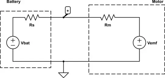

A better model for a DC electric motor is there is some resistance in series with a variable voltage source.
Additionally, a battery has some internal resistance, which can be modeled as a series resistor*. A PC power supply also can use this same model, but the series resistance is likely to be smaller. The system then looks like:
schematic
We can explain why in the first case your measured voltage is less than the no-load battery voltage because we have a voltage divider. Doing some math,
\begin{align} V_{emf} = V_+ - I R_m\\ R_s = \frac{V_{bat} - V_+}{I} \end{align}
You measured \$R_m = 3.5 \Omega\$, \$I = 0.19 A\$, and \$V_+ = 2.9V\$, so \$V_{emf} = 2.24 V\$ and \$R_s = 1.47 \Omega\$.
In the second case, \$V_+ = 4.92V\$ and \$I = 0.28A\$. Thus: \$V_{emf} = 3.94 V\$ and \$R_s = 0.43 \Omega\$.
Notice that \$V_{emf}\$ is different between the two. This is because \$V_{emf}\$ is roughly linearly proportional to how fast the motor is spinning. You should have observed the motor spinning faster when hooked to the 5V supply.
Additionally, how multi-meters measure current is by introducing a series shunt resistance and measuring the voltage across this resistor. This further complicates the analysis, so the measured current and load voltage are not exactly correlated. It's more difficult to do this analysis, but is possible if you know the series shunt resistance. This is sometimes quoted as a "burden voltage" at a rated test current and you can use Ohm's law to recover the shunt resistance.
It is possible to reconstruct what the measured load voltage should be with just a single meter, but it requires more information on how \$V_{emf}\$ behaves which is beyond the scope of this answer.
If you set your meter to the largest current range this will use the smallest shunt resistance, you can minimize the impact of having the meter in series at the cost of losing a bit of accuracy.
*note: Batteries don't have a constant internal resistance, but this is a reasonable approximation. It depends on a ton of factors including but not limited to stored energy, temperature, and load.

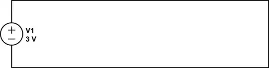

Using the multimeter to read the battery voltage (with nothing connected) I got 3.18V, which makes sense because they were fresh AA batteries. I then decided to connect the pump and read the voltage on the two connectors on the pump. This read 2.9V, which was surprising to me because apparently 0.28V had disappeared.
Consider what would happen were this not the case. What if you could connect a load to the batteries and the voltage remained unchanged? What if that load is just a wire?
schematic
How much current will flow here? Well, an ideal wire is a 0Ω resistor, and there are 3V across it. Using Ohm's law, we can divide 3V by the resistance to get the current (\$I=E/R\$):
$$ I = \frac{3\:\mathrm V}{0\:\Omega} $$
In practice wires have some resistance, so we don't actually end up creating a universe-ending singularity. What if the wire is pretty short and fat, and has a resistance of 0.0001Ω?
$$ I = \frac{3\:\mathrm V}{0.0001\:\Omega} = 30000\:\mathrm A $$
Wow that's a lot of current. I'd expect that wire to be vaporized in an instant.
