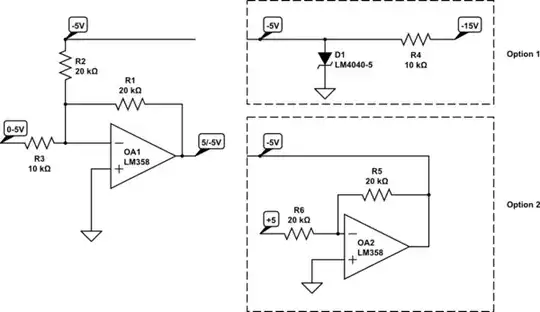

Assuming the galvo amplifier has a relatively high impedance input (doesn't draw more than a few mA) you can use this circuit:-
schematic
The amplifier has a gain of -2 from the DAC output, and D1/R2 biases the voltage at +5V out with 0V in, so the output will change from +5V with 0V in to -5V at 5V in. R4 provides some vias current for D1, which is the -5V reference to offset the amplifier.
If you want to avoid D1 and have a 5V reference already, you can use the remaining amplifier to get -5V from the +5V reference as shown in the dashed box.

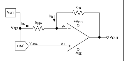

You should use the reference voltage that you supply to your DAC as a means for generating a proper bipolar output using an op-amp: -
This is the most accurate method of acheiving what you want. TI also show the same type of circuit: -
They describe their circuit as: "Bipolar +/-10V Output from a Unipolar DAC for Industrial Voltage Drivers" but this is an enhanced range due to the addition of RG1.
