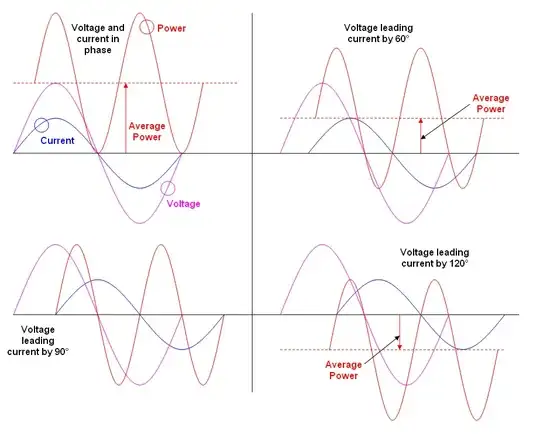

So the waveform of current in a capacitor "follows" the differential of the supply voltage. If supply voltage is a sinewave then current is a cosine wave i.e. (and here's the important bit) it is 90 degrees shifted forward and, if you were to calculate real power you would find, somewhere in the algebra, a cos(wt) multiplied by a sin(wt) and, there can be no escaping that this produces a waveform that has an average value of zero (go do trig!): -
You are billed on average power not peak power or (god forbid) RMS power or even reactive power.
Pretty graph stolen from here. Note that the power waveform is twice the frequency of the voltage or current. For a resistive load, V and I would be in phase and the power waveform would be wholly positive i.e. the blue waveform moves up as red and green become in phase.
See below for several scenarios of current phase displacement relative to voltage and what that means for the position of the power waveform: -
