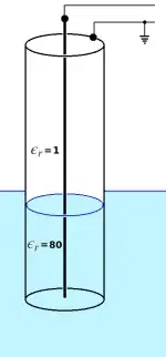

Water has quite a large dielectricity constant (ca. \$\epsilon_r = 80\$), i.e. the capacitance of a capacitor normaly filled by air is changed much if air is replaced by water.
You can build a capacitor consisting of a vertical tube with a wire (or rod) along its center axis (aka coaxial capacitor). Tube and wire form the two electrodes of the capacitor. Of course the tube and wire have to be conducting but they should not be in electrical contact with the water (i.e. they should be insulated because waters is conductive), therfore you don't have problems with electrolysis or other forms of corrosion:
Depending on the waterlevel inside the vertical tube capacitor its capacity changes between some base value \$C_0\$ (0% water level) and \$\epsilon_r C_0\$ (100% water level).
Use the tube capacitor as frequency determining element of an RC (or LC) oscillator in order to measure its capacity via the osciallators frequency (\$f\$~\$\frac{1}{C}\$).

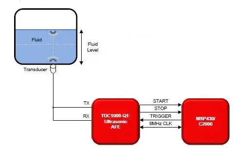

Disclaimer: In the essence of time this response is an cut paste of response to a Can I use a ultrasound sensor to measure water level?. Configured the sensor detect water levels, with can be combined with a electronic valve to control the water level. If interested there are few reference to help seek additional infomation.
Technology used in depth finder, in marine application is mostly like is the best to measure the water from the top.
To measure water level from the bottom of tank one could use a piezo electric ceramic transducer combined with an Analog Front End (AFE) and a micro-controller to measure water level. The diagram below best explains the configuration.
Fluid Level Sensing
You can use a piezo electric ceramic transducer from Steminc, TDC1000 AFE from Texas Instrument and a MSP430 micro-controller also from Texas Instrument. There might be other configurations, but currently I am only aware of this configuration.
Piezo Electric Transducer
Transducer 1 Transducer 2
Analog Frond End
Click on image for a larger version of the image.
Limitation: The thickness and material of the tank might be an issue. For the most part above configuration work with plastic.
