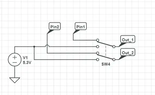

If you are going to use a mechanical switch anyway,then this one is simple and cheap. Both your supplies will be mechanically isolated.
Mech
