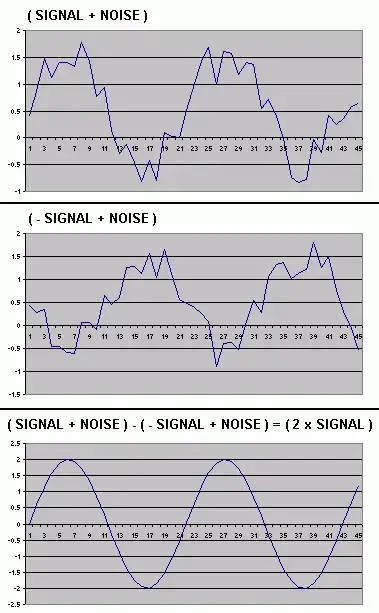

For common mode signals you get two wires: one with a signal and one with the inverse of that signal. If you add them you'll get zero, if you'd take the difference you'll get the signal.
What's the cool thing about this. If the two wires (the pair of wires) picks up some noise. Than the noise will be added on both wires. If you add the two signals you only keep the noise.. But if you take the difference you'll get the signal without the noise.
Signal is S (without noise)
Cable a => S
Cable b => -S
The Difference is S - (-S) = 2*S
Signal is S (with noise)
Cable a => S + noise
Cable b => -S + noise
The Difference is (S+noise) - (-S+noise) = S+S+noise-noise = 2S
So the noise will be cancelled.
example image: enter image description here

  • Thank you! But my question was specific to differential amplifiers. Both inputs to the differential amplifier need not be equal and opposite. What would be the meaning of common mode voltage in such case? – JGalt Aug 29 '15 at 15:18
    My answer is specific about differential amplifiers: "The Difference is (S+noise) - (-S+noise) = S+S+noise-noise = 2S" This is specific on the input of the differential amplifier – Bruce Aug 29 '15 at 15:24
    Also there is something called CMRR common mode rejection ratio this is a very high value that represents the attenuation on the input of common signals like noise. – Bruce Aug 29 '15 at 15:25
