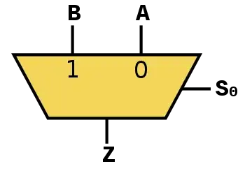

I haven't done EE for quite a long time. I need to implement some MUX, so I started with a two-way MUX. But I don't understand how to make the decision:
Wiki- Multiplexer
A truth table will show that
This truth table shows that when S=0 then Z=A but when S=1 then Z=B.
I don't get the logic here. The boolean expression is Z = (A and S') or (B and S)
