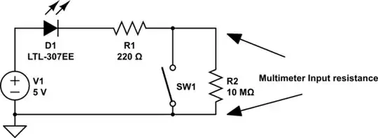

I've searched the forums but can't find an answer for my issue. I've got a simple LED circuit powered by 5V DC. When the switch is closed, I've got 2.8V across the resistor, 2.2V across the LED, and 0V across the switch (as expected).
However, when the switch is open, I get 3.45V across the switch but no other noticeable readings (0V across resistor and 0V across the LED). Where did the other 1.55V go? If I shunt across the LED, I get the expected 5V across the open switch connections. How is there a voltage drop across the LED in an open circuit and why can't it be measured with a DMM?

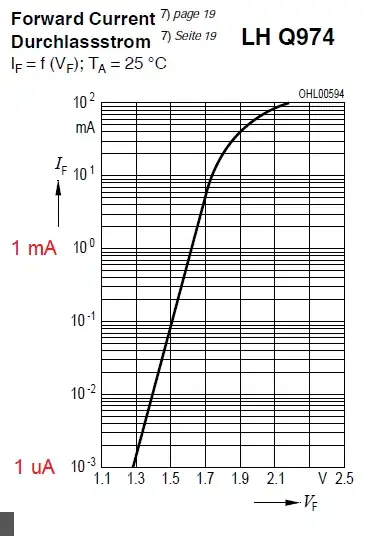

It comes down to the LED still conducting current when it is not illuminating. Take a look at this characteristic from an OMRON LED. It's very rare to see stuff like this in data sheets: -
This shows the volt drop (about 1.3 volts) across an LED when 1 uA is flowing and it's not unreasonable to expect all LEDs to behave within a ball-park or two of this. So you are seeing a volt drop across the LED due to the current through the meter's inputs when placed across the open switch. If the meter's input resistance is 10 Mohm then there is about 0.345 uA flowing and there will be probably over a volt dropped across the LED should it be the device in the picture above.

    Thanks for the reply. This makes sense. I guess I need to use a second DMM to check for a voltage drop across the LED when the first DMM is connected across the open switch. – user84102 Aug 26 '15 at 14:29
  • See this document about the diode equation and how it pertains to LEDs: http://www.lumileds.com/uploads/225/AB20-3A-PDF – Andy aka Aug 26 '15 at 14:35
    @user84102 a meter across the LED is going to shunt the LED current and make the original meter voltage a wee bit higher. Not easy to measure. – Andy aka Aug 26 '15 at 14:49

It has to do with the internal resistance of your multimeter. The high impedance on the multimeter input is basically creating a path to ground when you measure the open switch. So therefore when you make your measurement, it is the equivalent of adding a high value resistance( in the order of 1 to tenths of megaohms depending on your meter ) in parallel across from where you are taking the measurement in this case the open switch.

  • I understand what you're saying but I'm still missing something :-( If the meter is loading the circuit and causing a voltage drop, why does the load (voltage drop) not show up if the diode is removed and replaced with a wire? I get the full 5V reading across the open switch when the LED is shorted with a piece of wire. – user84102 Aug 26 '15 at 14:24
    That is exactly what you would expect, if you replace the LED with a short then with the loading effect of the multimeter you end up with the voltage divider of 200 ohm and the multimeter impedance which results on a voltage drop of 5V(1MOhm / (1MOhm + 220Ohm)) = 5V.99978 or 5V. so the voltage drop across R1 is very insignificant that is negligible – Kvegaoro Aug 26 '15 at 14:52
  • Got it - Thanks!!!! I didn't realize the diode would conduct that much voltage at such low current. Makes sense now. – user84102 Aug 26 '15 at 15:00

You could assume the multimeter is a resistor with very big resistance (several Mega Ohm).
When you measure the switch voltage, although the switch opens, you make a closed loop circuit, so you can read the voltage on the multimeter itself (3.45V).
When you measure the resistor voltage or LED voltage and the switch opens, the circuit is open. There is no a close loop circuit, so there is no current and no voltage across the multimeter.

  • So, is the 1.55V volts being dropped across the diode when the meter bridges the switch? If I remove the diode and replace with a wire, and then measure the voltage across the open switch, I get the full input voltage (5V) on the meter. – user84102 Aug 26 '15 at 13:55
