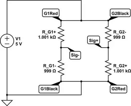

    Your sensor is almost certainly a "half bridge" of two strain gauges - they form the right hand two resistors in Steven's first diagram - ie "R2" and "strain gauge" as he has them labelled. One wire will be the top of bridge connection, one the bottom of bridge connection and one will be the common connection between the two. Measuring between two wires at a time common to top and common to bottom will be the same resistance. eg name wires T B C (top bottom common). T to C = R, B to C = R, T to B = 2R. Connect common to right hand middle of bridge, connect T & B to top and bottom. – Russell McMahon Aug 27 '11 at 07:00
    I agree, looks like a half bridge, and the wiring in the diagram looks okay. Just the resistors (and maybe bypass/compensation caps - in the instrumentation amp question we discovered it was oscillating..) are missing. Confirming beyond doubt the part number (i.e single/dual) would be useful. – Oli Glaser Aug 27 '11 at 11:01
  • @OliGlaser -- Swap the excitation for one of the gauges. As-is it is measuring the difference between the two gauges. If the the OP wants to measure the changes to the sum of the weight applied to the pair of gauges, they should be setup to increase the unbalance as they load up. – Dave X May 04 '23 at 01:31

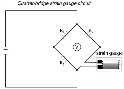

The strain gauge is a variable resistor, so your first idea may to build a resistor divider with a second, fixed resistor to detect the variations as a change in voltage.
Unfortunately strain gauges are very insensitive variable resistors, whose resistance changes only very little when weight is applied to them. A resistor divider is not nearly sensitive enough to detect the changes. So we need another approach.
A Wheatstone bridge is the solution.
Wheatstone bridge
The strain gauge together with R2 still form a resistor divider, so how is this different? Let's assume that all resistors have the same value, equal to the strain gauge's resistance at rest. Then the voltage across the voltage meter will be zero instead of half the power supply. Since our reading is zero referenced we can amplify it easily to get a higher sensitivity for the complete circuit.
Oli mentioned the differential amplifier, but this isn't going to be enough. We don't want to affect the reading by putting a load to it, like the differential amplifier would. We need an instrumentation amplifier, which is a differential amplifier with a very high input impedance. This is the most used instrumentation amplifier configuration,

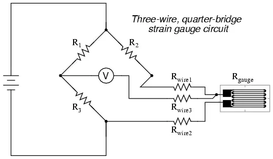

Now, how do we connect the strain gauge, because it has three wires, not the two like in the above schematic? Again the datasheet is no use here, but you probably connect it like this:
This way of connecting compensates for the wire resistance \$R_{WIRE 1}\$, which otherwise would affect the reading.
Another possibility is that the wires represent the top, right and bottom point of the Wheatstone bridge, resp. Which one it is can be easily determined by measuring the resistance between wires. In the first case you'll have no resistance between \$WIRE 1\$ and \$WIRE 3\$. In the second case you'll measure an equal resistance between red-white and white-black (you may have to switch wires. Again, the datasheet doesn't help).

  • Thanks for your answer. I'm still totally confused though. I don't understand how to read those schematics. What does the V with the circle around it mean? Do the zig-zag lines mean resistors? What sizes are those supposed to be. Where is the amplifier in your last schematic? How would I connect that circuit to the amp? – Andrew Aug 29 '11 at 05:00
  • @Andrew - The V in the circle is the symbol for a voltmeter, here it indicates between which two points you'll measure, so those points are the inputs for the instrumentation amp. The zig-zag lines are resistors. R1 = R3, exact value not really important, take for instance 10k. Your R2 is possibly part of the sensor, then you connect the 3 wires to top, right and bottom of the bridge. – stevenvh Aug 29 '11 at 06:21

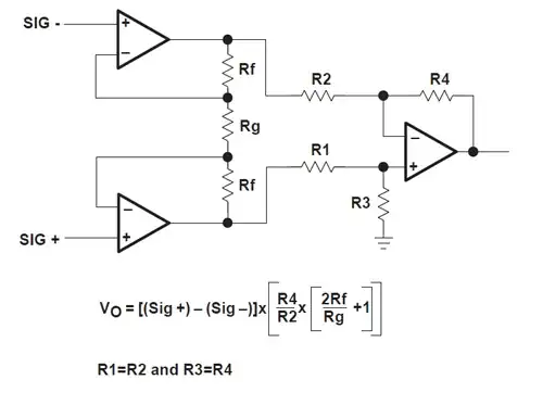

Note - I left the bottom part as another option as I didn't notice the package difference straight away.. edit still not quite sure how many opamps are available.
You may want to read up on (basic) opamp theory (which I have not gone into as it is explained better than I can in lots of places, and can/does fill books) before attempting any of this, as it's very easy for things to go wrong (even when you supposedly know what you are doing) They are not like some ICs that "just work", and the frequent source of much frustration for the new user of them.
The part you link to is a dual opamp (two opamps in one package) with no offest null or NC pins (see below for explanation of these) Here is the pinout from the datasheet:
You can do the single amp option below still, but since you have two opamps the two opamp version on page 4 of the TI app note is a better choice (works a bit better as it does not affect the input signal as much) The resistor values can be worked out with the equation, aim for a gain (the Vo part of the equation) of >100. Note that Steven goes into more detail about the downside of this option, and says it will not be "enough". I don't agree entirely - it's far from ideal, but it can be made to work if you adjust the gain to compensate for loading, as explained in the TI app note linked to above. However the result will be slightly non linear as impedance changes with input voltage at the inverting input. So if you have more than one opamp the instrumentation amplifier is the way to go.
Single opamp option
You need to make a differential amplifier, like this:
Wiki Differential opamp example
For your application, something like the values on page 3 of this application note would be appropriate. It is preferable to use something called an instrumentation amp for this, which uses 3 opamps, but you can make it work okay with one. The resistors set the gain of the opamp.
THe NC means "No Connect", so don't worry about that pin. The offset null is used to trim the very small offset (usually a mV or so) between the two inputs (ideally would have no offset)

  • @Andrew - If you want to build the two-opamp instrumentation amplifier from the appnote Oli refers to, note that the amplification given in the appnote is wrong. Corrected equation here – stevenvh Aug 27 '11 at 17:20
  • @Stephen - well spotted, is indeed. It relies on R1=2=3=4 being equal, but in the note it is given as R1=R2, and R3=R4. Including the R3 term allows for this though. – Oli Glaser Aug 27 '11 at 18:01

Try reversing the voltage to one of the two strain gauges. This has the effect of doubling the amount of voltage change. Wiring them the same generates ~ the same voltage at both amp inputs which equals zero differential.
Wayne
    Can you explain a bit further on this, right now this seems more of a comment. – Kortuk Aug 22 '12 at 01:09
  • The sensors contain two strain gauges, one in tension and one in compression. Wiring both sensors in parallel, with equal loads, will change both the inverting and non inverting inputs by the same amount, rejecting the increased load as Common Mode noise. As specified, the circuit will measure the differences in loads on the two sensors. – Dave X Nov 09 '15 at 20:41
What Wayne said.
The sensors contain two strain gauges, one in tension and one in compression. Wiring both sensors in parallel, with equal loads, will change both the inverting and non inverting inputs by the same amount, rejecting the increased load as Common Mode noise. As drawn, @Andrew's circuit will measure the differences in loads on the two sensors, not the sum.
If you want the sum of the loads on both gauges, swap the excitation voltage on one of them like this:
Then, assuming a load changes the resistance of each of the 4 strain gauges by 1 ohm, the voltage across the center of the bridge is 4mv:
schematic
Then, once you've got the increasing sum of the weights unbalancing the op-amp, configure the amplifier to amplify, as per the other answers.
