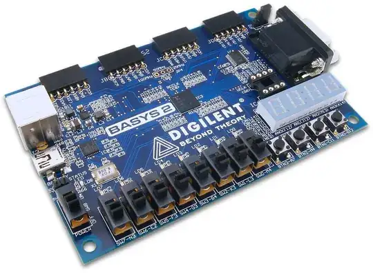

I went through this free VHDL fpga course recently and it was great. It goes over a bunch of different projects and gives a general overview of the language. There is some go out and do it on your own projects which can be frustrating if you start and don't know where to go but it was a great challenge.
I used the Basys 2 board and it worked just fine for the course. I have not used anything else besides Digilent boards but I feel that their program has a great debug and bit file loader. enter image description here
