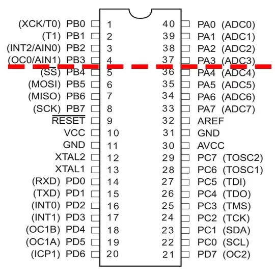

As far as I understand, the die of a DIP package is located at the center and the rest is just the lead frame. Given that I have unused pins, can I cut the top part of this microcontroller (ATmega16/32)? Will it still function afterwards?enter image description here

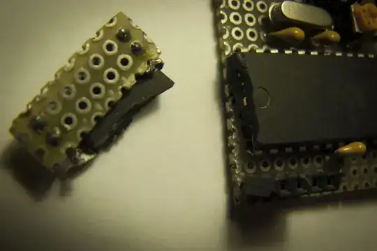

Edit: thank you for all the answers. I have realized that cutting an IC is a delicate process and there is a high risk of damaging the chip. But I've done it anyway, shear cutters worked a treat. I decided to go for the 3 lower pins instead of the upper ones since they are further away from the ISP connector. Here is a photo of the final result (My new DIP-34 package works just fine):

    @DewiMorgan - using a Dremel was my initial intent, but I started to worry about static. Veroboard also helped to reduce the stress a bit. – v.m. Aug 03 '15 at 01:48

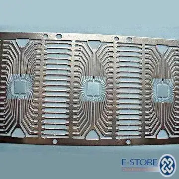

EDIT: I got curious and looked up pictures of DIP lead frames. Here's a picture of some DIP-36 lead frames on a reel that I found at a wholesaler's site:
Three DIP-36 lead frames, still joined from the factory

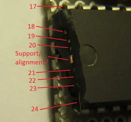

And here's a labeled close-up of the cut side of your package:
Labeled close-up of cut DIP-40

    Yeap, chip seems to work just fine. Shear cutters did a good job - I've added a photo of the final result. – v.m. Jul 31 '15 at 23:09
  • Fascinating! I got curious and looked up some pictures of DIP lead frames. My answer now includes pictures showing what we're probably seeing in the cut. – Adam Haun Aug 01 '15 at 03:25
    The center lead is connected to pin 11 (ground). Interesting observation: the resistance between pins 11 and 31 is about 2 ohms, although they should both be connected to ground. – v.m. Aug 01 '15 at 09:47
  • @v.m. 2 Ohms? Is this what your multimeter displays? Hint: Connect the two tips of your multimeter probes. If it still displays 2 ohms, it's your multimeter, not the lead you're measuring ;-) It'll just never go lower than 2 Ohms... – zebonaut Aug 05 '15 at 07:27
  • Of course I took that into account. There is a short between PIN11 and the center lead and about 2Ohms between pins 11 and 31. My guesses are: a) PIN31 is not connected to the center lead of the frame, but is routed through the die itself b) It was connected to the center lead but through the lower part of the frame (which I snapped off) – v.m. Aug 05 '15 at 16:55
  • I think a) is probably correct. – Adam Haun Aug 05 '15 at 22:37
