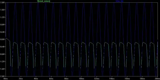

At Russell's behest, I built the NMOS version and it worked even though the simulations show only a dampening for the positive swing:
This was the circuit that was simulated and built/tested: enter image description here
Simulation result: enter image description here

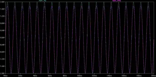

Oscilloscope measurement (when forgetting to ground the Source, or having very high R to ground): enter image description here
Oscilloscope measurement with the 6.8k resistor from S to GND: enter image description here

    You'll want base resistors from base to Vcont and inverse. Reverse biased transistors tend to act like very low beta versions of the same which may or may not cause issues. Reversed biased junctions will breakdown above a certain voltage but probably OK here. | More formally proper and very effective is two MOSFETS of identical type (eg 2 N or 2 P channel in series opposed with sources joined and gates joined and two drains as bidirectional IO. Drive gates high wrt sources for N channel to turn both on and low wrt source to turn off. In this case drive to high and low rails OK .... – Russell McMahon Jul 25 '15 at 15:46
  • When off, how much attenuation do you expect to see from input to output and don't say infinite cause it won't happen? – Andy aka Jul 25 '15 at 15:48
  • .... if AC lies between rails. Notionally you need drive wrt sources but doing as above tends to work due to strays and non idealities. If desired a say 2 x 1 megOhm from source to each rail will give a dc reference point which signal easily swamps when on. Vgate needs to be Vgsth + some above AC max for proper turn on. – Russell McMahon Jul 25 '15 at 15:49
